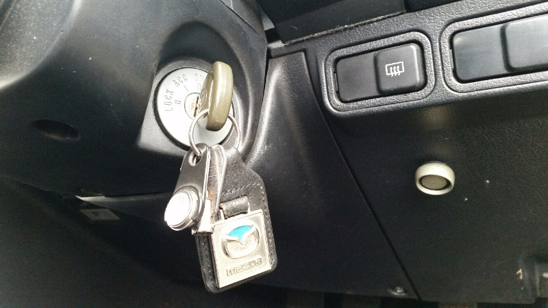

I have a 1.8 '95 Uk spec (manual gearbox, windows and steering!) Mx5 with the button type fob immobilizer.

noisebod wrote:I have a 1.8 '95 Uk spec (manual gearbox, windows and steering!) Mx5 with the button type fob immobilizer.
That can be removed very easily if needed, as it as been added here not at the factory.

Mazda Mender wrote:noisebod wrote:I have a 1.8 '95 Uk spec (manual gearbox, windows and steering!) Mx5 with the button type fob immobilizer.
I have a ‘95 U.K. Mk1 with exactly the same type of under-dash button immobiliser. I only have 1 button fob. I was planning to get a spare, but are you saying it would it be better to remove the immobiliser?

Yes as the electronics age they can become unreliable. There is a case to be made to remove the UK fitted immobiliser from these cars. As always it should only be removed by someone who understands what needs done to get the car starting reliably again after the removal of the immobiliser unit.

The aftermarket system can be removed easy enough as long as you have time and a good soldering iron and some confidence .

Mazda Mender wrote:The aftermarket system can be removed easy enough as long as you have time and a good soldering iron and some confidence .
I think I have this problem with my mk1 1994/1995 immobiliser, it blips and changes from red to green on the LED, but I’m not getting any spark on the plugs , the engine just turns over.
Are there any tutorial’s anywhere showing how to remove it?
